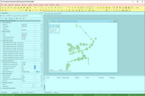

Example of the workspace
An example of the workspace when using an Innovyze licence:

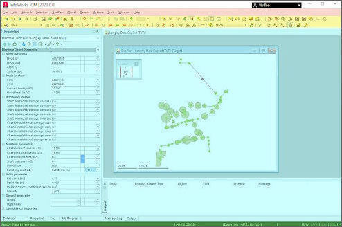

Application layout
An example of the workspace when using an Autodesk licence:

Pink - Menu bar, Yellow - Toolbars, Blue - Main Window, Green - Status bar
