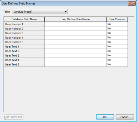

The dialog is displayed when you select Database managementUser defined field names from the File menu, and is used to edit the field names of User Fields for the current database.
Both Model and Asset network field names can be edited.
Note: If the database global settings are protected, only database owners will be able to make changes to User Defined Field Names (See User Permissions for more information.)
User Defined Field Names Dialog displaying InfoWorks Network user fields
User Defined Field Names entered in the dialog will be used as the global default for the current database. However, network specific User Field names will override the global default names. See Editing Global User Defined Field Names for more details.
For Asset networks it is also possible to edit the choice lists for User Text fields via this dialog. Click a user text row and click the Edit Choice List button to display the Standards and Choice Lists Dialog. See the InfoAsset Manager help for details.
