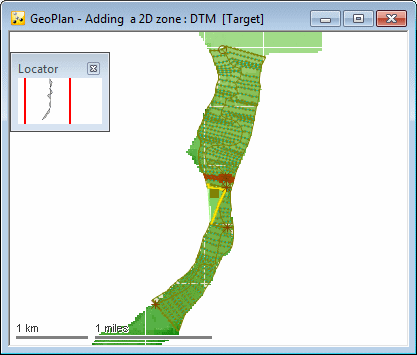

- Drag the Adding a 2D zone network onto the main window.
- Drag the
DTM ground model imported in the earlier exercise onto the main window.

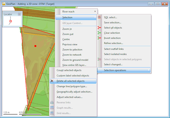

- The new 2D zone will replace the 1D storage area added in the
first tutorial. So, the first step is to remove the 1D storage node and its associated storage area. Select both items (use
CTRL+Click to select multiple items) and then right click on the GeoPlan and choose Selection
Selection operations
Delete all selected objects from the context menu.

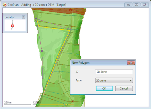

- From the New Object toolbar item, select Polygon as the required object type. Then select the New Object button
- Draw in a new polygon which encompasses the bank line and the reach section ends. When prompted, set the ID as 2D Zone. Set the polygon Type to 2D Zone as well. Note that the 2D zone must have ground model data underneath its entire area. If any area of the 2D zone falls outside the ground model boundary, an error message will be flagged up during the meshing process.

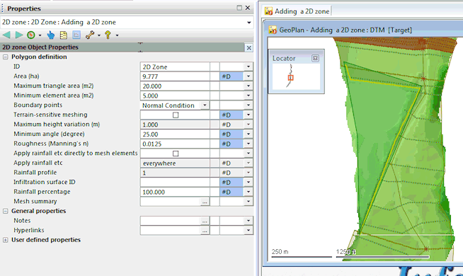

- Using the properties tool
, select the 2D zone and set the various parameters required. In particular set:
- Maximum triangle area to 20.0 m2
- Minimum element area to 5.0 m2
- Boundary points to Normal Condition
All other items can be left at their default settings.

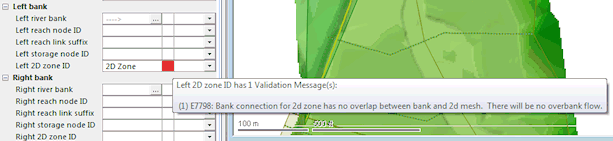

The properties of the River Reach will report that a connection has been made between the reach and the 2D zone, but that, at the moment, there is no hydraulic overlap between the zone and the bank. This would lead to a situation where there would be no overbank flow. Creating a Mesh within the 2D zone will resolve this problem.

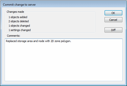

- Every time a version-controlled item, such as the network, has been changed, it is good practice to commit the changes. Changes are stored in your own local copy of the network (in your
Local Working Folder directory) and must be committed to the database so that they become available to other users. Also, committing changes on a regular basis allows you to discard all the changes you have made since the last time you committed the network to the database.
- In the Explorer window, right-hand click on the Adding a 2D zone network and select Commit changes to database.
- The Commit change to server dialog is displayed.
- Type in any notes as appropriate.
- Click OK to commit the changes and close the dialog.
- If a message is displayed asking you if you wish to validate the network at the same time as you are committing your changes, click No for now. We will validate the network at a later stage.
At the moment there is no hydraulic overlap between the zone and the bank. This would lead to a situation where there would be no overbank flow. Creating a mesh within the 2D zone will resolve the problem.
