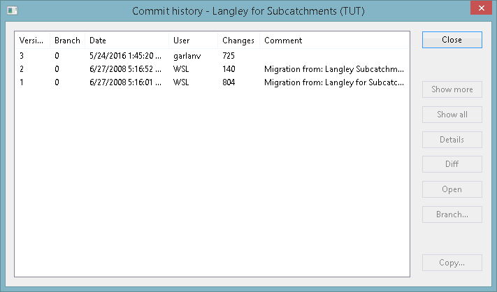

Viewing the Commit History
- Right-click the ‘Langley for Subcatchments (TUT)’ in the Explorer window and select Show commit history from the pop-up context menu. The Commit History dialog is then displayed.
- Select the Close button when you are finished viewing the history.

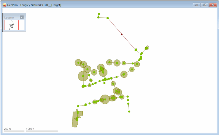

Opening and editing a Network
- Right-click the 'Langley for Subcatchments (TUT)' network in the
Explorer window and select Open from the pop-up context menu.
Alternatively, drag the required network from the Explorer window to the middle part of the main window.
The selected network is then displayed in the GeoPlan.

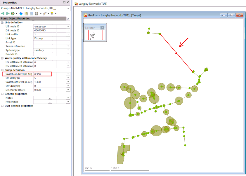

- Click the properties button
, located on
GeoPlan Toolbar, and the
Object Properties is displayed.
- Make a small change to the pump, such as changing the Switch on level to 8.9.

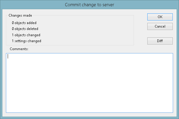

Committing the changes
- Right-click the 'Langley for Subcatchments (TUT)' network in the Explorer window and select Commit changes to database from the pop-up context menu. The Commit Changes dialog is then displayed.
- Enter a comment, such as 'Changed pump switch on level from 2.7 to 8.9' and click OK.

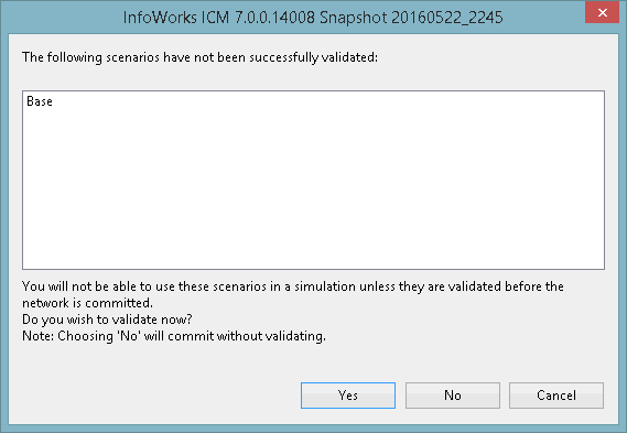

If the network contains any scenarios, then a message is displayed asking you to validate the network.
- As network validation is covered later in this tutorial, click No to commit without validating the network.

- Check the commit history for the network. Right-click the ‘Langley for Subcatchments (TUT)’ icon in the
Note that there are now two versions of the network shown in the commit history.
- Click Close when you are finished viewing the history.
