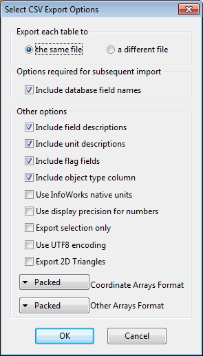

- Select the Export
to CSV files option from the Network menu. The
Select CSV Export Options dialog is displayed.
- Ensure that the a different file option is selected. The CSV files imported earlier contained all the data in one file. This time the export process will create a series of export files, one for each type of data.
- Check the Export selection only option. Leave the other options as they are and click OK.
If you want to export the entire network, do not check the Export selection only box.

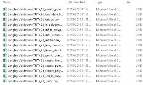

- Open the newly created 'Export Files' directory. The default filename ('Langley Network_node.csv') is acceptable, so click Save. You can choose any name you like, as long as it ends with '_node.csv'.
Files are created for each object type, with the first part of the name the same in each case and the last part indicating the type of data.

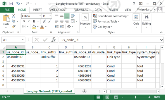

- Open 'Langley Network_conduit.csv' in Excel.
The file contains the complete set of fields (including data flags if the Include flags fields option was chosen) for all the conduits that were part of the selection in the network.
