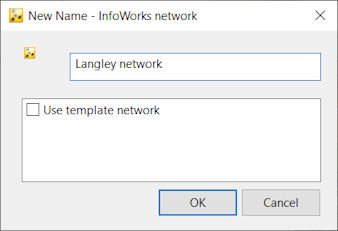

- The
New Name dialog is displayed. Enter a network name, such as 'Langley Network', and click OK.

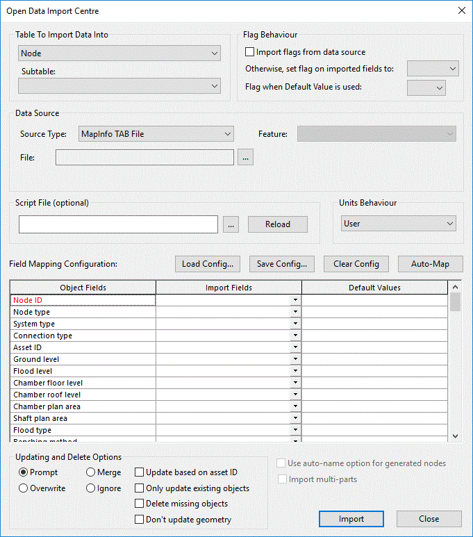

Open Data Import Centre, and the
Open Data Import Centre dialog is displayed.
This dialog will be used to import data from GIS files. You can also use the dialog to import data from a variety of other sources.
- Check that the Table to Import Data Into is set to Node and the Source Type is either MapInfo TAB File, Raw Shape File, or Geodatabase Layer, depending on your GIS.
- Click the
button in the Data Source section. Browse to the 'Example Data Directory' and select the 'Tutorial Files/Import Files/GIS Data' folder.
- Open the MapInfo or ArcView folder, click the 'iw_node' file and click Open. This file contains data that defines the nodes in your network.
- Click Auto_Map. This button searches the import file for fields that match those that define the nodes in the network.

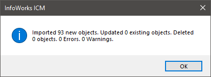

- Click Import to import the GIS data.
- When the data has finished importing, click OK.

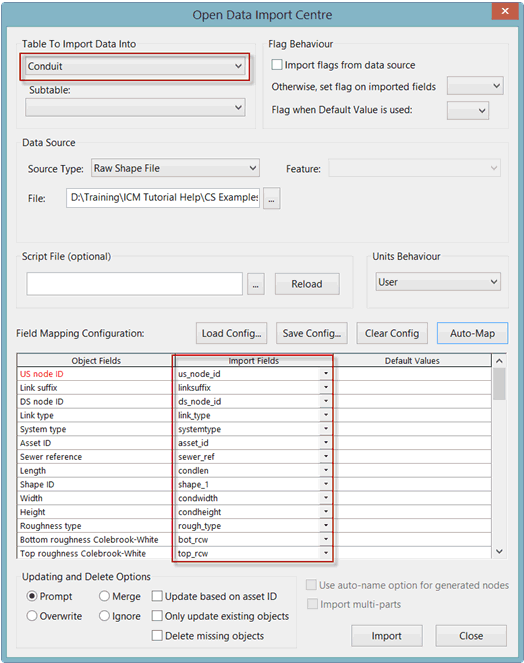

- Change the Table to Import Data Into to Conduit.
- Change the Data Source to iw_conduit.
- Click Auto-Map.
- Click Import.
- When the data has finished importing, click OK on the displayed information message.

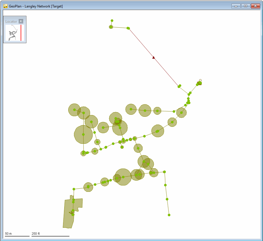

- Click Close when all files have been imported. The network is displayed in the GeoPlan: The network describes the physical aspects of the system.

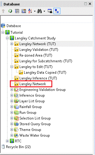

The new network is now included in the Langley Catchment Study Group.
Drag the edge of the Model Group window to make the window wider if necessary.

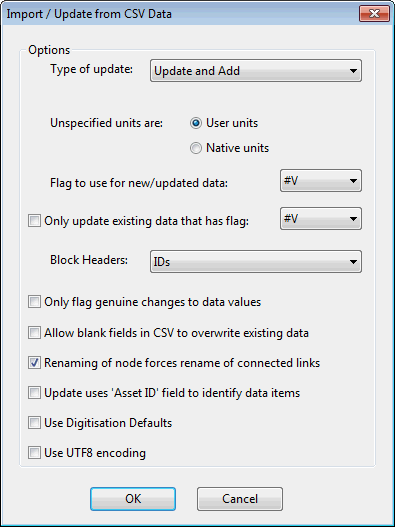

- Update the network with the data in the CSV files:
- Select the Import
Update from CSV files option from the Network menu, and the Import / Update From CSV Data dialog is displayed.
- Check that the Block Headers is set to IDs. All data in the database has a data flag, which indicates the source or reliability of the data.
- Click OK.

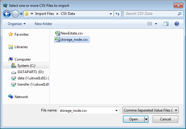

- From the Example Data Directory, select Tutorial Files/Import Files/CSV Data/storage_node.csv and click Open.
- After the data has been imported, the import directory is redisplayed. Click Cancel. This window closes and a text report which shows the results of the update, is displayed:

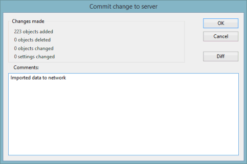

- Commit the changes to the new network:
- Right-click the Langley Network in the
Explorer window and select Commit changes to database from the pop-up menu, and the
Commit Changes dialog is displayed:
Enter a suitable comment about the update and click OK.

- Close the GeoPlan view by clicking
You can now begin to explore the imported network and investigate the facilities that are available in the GeoPlan view.
