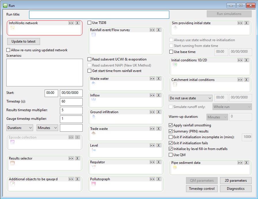

Run from the pop-up menu. The
Schedule Hydraulic Run
dialog is displayed.

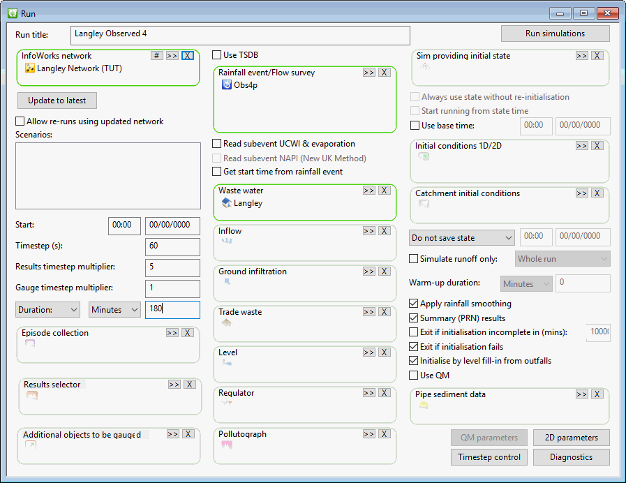

- In the Run title field, enter the title as 'Langley Observed 4'.
- Drag the 'Langley Network (TUT)' icon from the
Explorer window into the
InfoWorks network box.

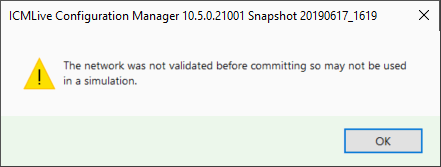

If the network has not been validated, a message is displayed informing you of this:
Click the OK button to close the message window and then validate the 'Langley Network (TUT)' as described in the topic Validating the Network. When the 'Langley Network (TUT)' network has been validated, drag its icon into the InfoWorks network box.
- Drag the 'Obs4p' rainfall event into the Rainfall event/Flow survey box.
- Drag the 'Langley' waste water event into the Waste water box.
- In the Run parameters pane, set the Finish to Duration in Minutes from the drop-down lists and then type '180' into the adjacent field.
You need to allow a sufficient duration for the Obs4p event, which contains the data for a 2½ hour storm.

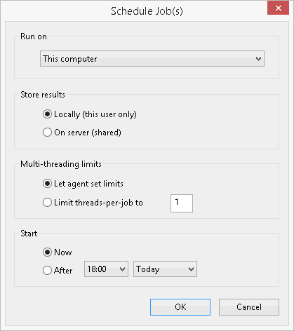

- Click the Run Simulations button, and the
Schedule Jobs dialog is displayed.
- Choose to Run on This computer, to Store results Locally, and to Start Now.
- Click OK. The
Schedule Jobs dialog closes and
InfoWorks ICM begins the simulation.

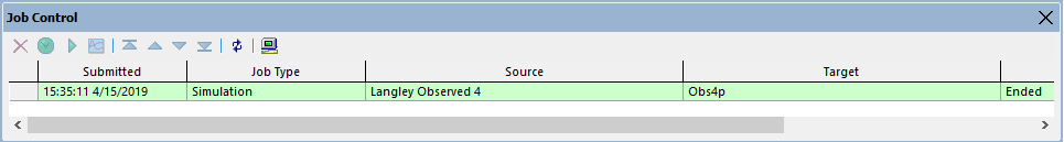

You can look in the Job Control and Job Progress windows to see the progress and status of the run. The Job Control window can be displayed by either clicking the
icon on the
Docking Windows Toolbar or by selecting the Job Control window option from the Window menu. Similarly the Job Progress window is displayed by clicking the
icon on the
Docking Windows Toolbar or by selecting the Job Progress window option from the Window menu.

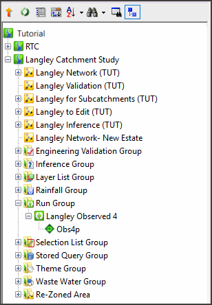

- Click the
(Expand) button to the left of the 'Run Group' and you will see that it now contains the 'Langley Observed 4' run, which in turn contains the 'Obs4p' simulation.
The simulation icon is green, indicating that the simulation was completed successfully. This does not mean, however, that the model run has not suffered from any instabilities.
