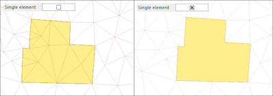

You can use the Single element box to choose whether or not the building is to be represented as a single element in the mesh.
If you want to represent the building as a single element, a mesh zone with minimum element size slightly greater than that of the building area is applied, which forces the building to be represented as a single element.
