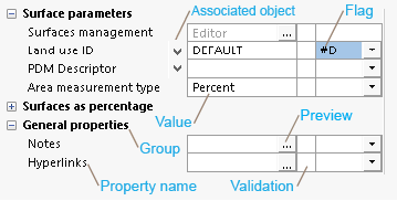

Excerpt of Properties
Properties are initially classified in system-defined groups. A user may add, delete and rename groups, and save the layout on a per user basis. This behaviour does not apply to result groups.
Property items are object-dependent and may contain the following parameters:
Property Item |
Description |
Name |
Field description which (ideally) uniquely identifies the object property and value units. |

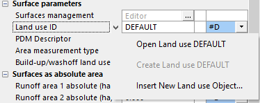

The
Example of an associated object context menu The context menu may contain one or more of the following options:
Value |
Either the object property value or a visual cue indicating that a preview of the object property value is available. Tip: If there is not enough space for a property value in a box, click on the
button to display more information (i.e. notes, hyperlinks).

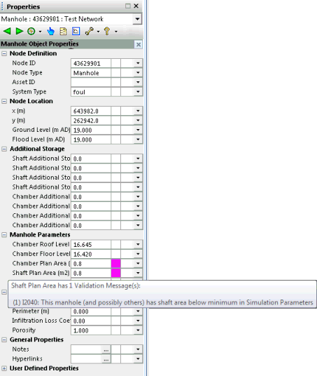

Validation |
Validation errors are displayed against each property by default. A coloured icon indicates if the object property has a validation error or warning (If the cell is empty, there is no validation error or warning). Hovering over a validation icon with the mouse will display a tooltip with details about the validation error, such as the name of the network object where the anomaly occurred as well as the cause of the error/warning. See Tooltips section below for further details. It is possible to hide the validation messages on the OPW (See Object Properties Window Settings dialog for more details). |

Tooltips
When some areas of the OPW (e.g. DropTree, property, validation error) are hovered over with the mouse, a non-editable and non-customisable tooltip with some information of the item being hovered gets displayed.
Example of property tooltip
Example of validation error tooltip

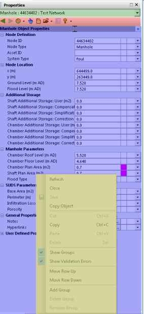

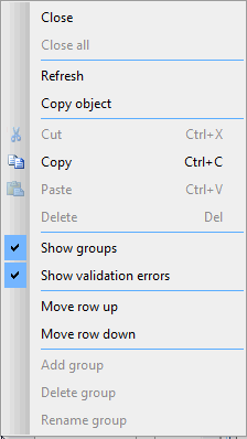

Context menu
Example of Context menu
When you right-click on a group, a property, a value, an error message or a flag on the OPW, a context menu like the one shown above is displayed, allowing you to perform a large variety of tasks.
Depending on which item is clicked, or which view of the OPW is displayed (network object properties, results properties or object type layout), some of the options may be disabled. See Using the Object Properties Window for more details on each of the available options on the context menu.
