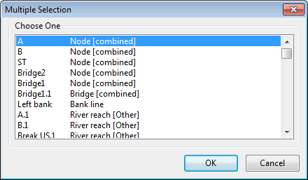

This type of dialog is displayed when you need to select an item from a list. For example:
- You are attempting to pick an object on the
GeoPlan Window but the pointer is close to more than one component. All network objects close to the pointer are listed.
- You are opening a completed simulation. The ways in which the simulation can be opened, such as replay, log results or properties, are listed.
Select an item from the list and click OK.
