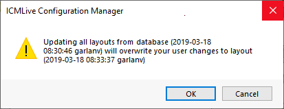

    If you have chosen to load the factory default layouts, a message similar to the following one is displayed:
    Warning message displayed when users are loading all layouts as factory defaults
    Click OK to load the factory default layouts or Cancel to cancel the load operation.

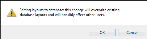

  5. Click Save to save the layouts.
    A message similar to the one shown below is displayed:
    Warning message displayed when pushing layouts to master database
    Click OK to save the layouts to the database or Cancel to cancel the operation.

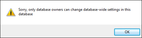

    Note: This operation may be permissioned and only made available to Database Owners, and a message similar to the one below will be displayed.
    Warning message displayed when users are not allowed to push their layouts to the master database

    Note: The delete operation may be permissioned and only made available to Database Owners. In that case, a message similar to the one below will be displayed.

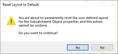

Resetting layouts
It is possible to reset the user-defined local property layout for the currently selected object. To do so:
  1. Select the Configuration MenuLayoutReset Object type (where Object type is the name of the currently selected type of object) from the Object Properties Window Toolbar, and a message similar to the one shown below is displayed:
    Warning message displayed when when restting a user layout
  2. Select Yes to reset the layout of the object properties to its factory default.
