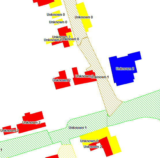

An example of an IAS plan is presented in Figure 1 below.
Figure 1 Example IAS Plan

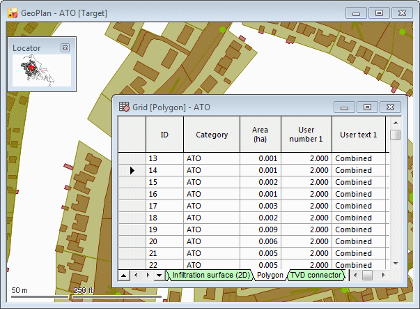

2.2 From Polygons Prepared in InfoWorks ICM

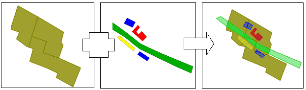

Polygons may either be created within InfoWorks ICM or imported using the Open Data Import Centre. Within the polygon grid all the polygons to be considered in the ATO must be given the same category. For the System and Surface Coding (described in section 2.1.1) the User Text is assigned to the System and the User Number to the Surface. For the Status Coding (described in section 2.1.2) the User Text field is assigned to the status codes.
A example of a polygon grid suitable for ATO is presented in Figure 2 below.
Figure 2 Example of ATO Polygon Grid

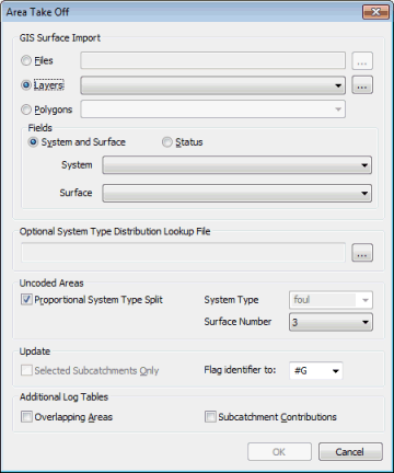

IAS is conducted by selecting Model > Subcatchment > Area take off.... The dialog box which subsequently appears is shown in Figure 4 below.
Click on the image for additional information about the dialog fields.
Figure 4 Subcatchment Surface ATO Dialog Box
3.1 GIS Surface Imports
There are three options to import the IAS data. The file option enables browsing for the appropriate file. If the file has been loaded as a layer, the layer option enables selection of the layer. The polygon option selects the polygons within the polygon grid that have an appropriate category chosen.
3.2 Fields
This element provides the choice between the system and surfaces codes method, or the older status codes method. Once a method has been selected, the drop down boxes allow the user to specify which fields from the GIS data supply the codes.
3.3 Optional System Type Distribution Lookup File
A System Type Distribution Lookup File can be used to define the percentage distribution between system types of IAS polygons that contribute to a mixture of system types.
These percentage distributions can be used where:
- IAS polygons contain System Type information
- The system type to have uncoded areas assigned to is specified
and / or
The lookup file is a csv format file containing the names of the mixed system types, as specified in the IAS file, and corresponding percentage distribution between user system types.
3.4 Uncoded Areas
There is a choice of whether the uncoded areas are divided between the four system types in the same proportion as the coded areas, or whether they apply to one specified system type. The surface number entered indicates the runoff surface (1-12) to which the uncoded area is to be applied. If a subcatchment does not contain any coded areas, then it is assumed to provide no contribution.
A full explanation of how uncoded areas are assigned, including examples, is presented in Chapter 4.
3.5 Selected Subcatchments and Flag Identifier
The flag identifier allows the flags on the contributing area and relevant runoff areas to be changed during the ATO process. (Prior to ATO, the flags on these fields must be set to #G).
There is also an option to only update subcatchments that are currently selected.

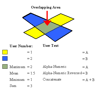

Imported data may contain overlapping areas that could cause inaccuracies in the imported values. Check the Overlapping Areas box to be warned in the log if any overlaps exist.
Check the Subcatchment Contributions box to include summary tables of GIS Area Contributions for each subcatchment.

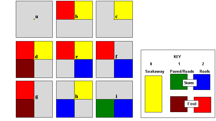

4. Example ATO Calculations
Figure 5 shows nine hypothetical one hectare square subcatchments numbered a to i. These subcatchments include different combinations of IAS codes. The accompanying Tables 2a and b, show how InfoWorks ICM calculates the total contributing area, the runoff areas 1 and 2 and the permeable area.
Figure 5 Combinations of ATO Codes
As shown in the key the IAS codes could either relate to the old Status colour scheme or the new System and Surface method. In the System and surface method a soak away defined as 0 applies to all system types. In this first example it is assumed that the 'Proportional System Type Split' box is ticked as described in section 3.4.
For example in subcatchment e, 0.25 hectares is roof draining to a foul system (red) and 0.25 hectares is a roof draining to a storm system (blue). The 0.25 of unassigned area is split in the proportion of the assigned areas (in this case 50/50) and the 0.25 hectares of soak away (yellow) provides no contribution. Therefore for the storm system, surface 1 (roads) is zero, surface 2 (roofs) is 0.25ha and surface 3 is 0.25/2 = 0.125ha. The contributing area is therefore 0.25 + 0.125 = 0.375ha.

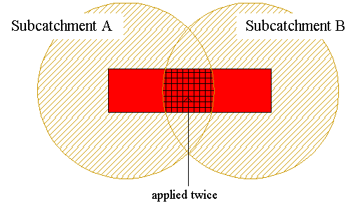

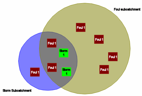

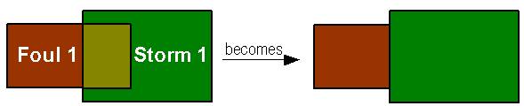

Now consider a more complex example. Figure 7 below shows two subcatchments that overlap each other. One is the same storm system shown in Figure 6. The other is a foul system that is 3 hectares in area and has 0.6 hectares of area coded as applying to surface 1 of the foul system and (the same) 0.2 hectares of coded area applying to surface 1 of the storm system.
Figure 7 Storm and Foul Systems ATO
Again there are three options for the application of the uncoded areas and in all three options the ATO for the storm system has not changed. This is fundamental to Area Take Off with overlapping subcatchments and different system types.
Whether or not a subcatchment is overlapping another subcatchment has no effect on the ATO for that subcatchment.
If the 'Proportional System Type Split' option is selected, then for the storm system, still 40% of the 1.5 uncoded hectares is applied. For the foul system there is 2.2 hectares of uncoded area. There is a 75/25 split on coded areas in favour of the foul system and therefore 75% of the uncoded areas applies to the foul system. Therefore 1.65 hectares will be applied. The application of areas in this option are presented in Table 5a below.

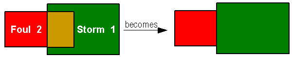

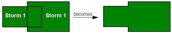

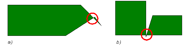

InfoWorks ICM supports most unusual shapes, including self- intersecting shapes and multipart polygons and calculates their areas correctly.
A self intersecting polygon touches or intersects itself. All areas are now considered.
Figure 8 Self Intersecting Polygons

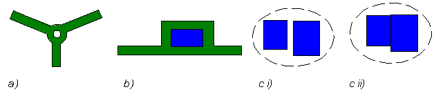

It is important to recognise that these shapes do not exist in reality and therefore InfoWorks ICM is only making the best possible approximation.
Multi-Part Polygons are polygons that have more than one boundary. For example a hole has an external boundary and internal boundary.
Examples:
a) Holes within IAS layer
b) Polygon within polygon (a hole if infilling polygon is removed)
c) Separate polygons combined as one or created multi-parts
Figure 9 Multi Part Polygons
Although InfoWorks ICM can make a reasonable assumption of how to interpret most shapes, there is still some IAS which cannot be imported. There are five main types of mistake in preparing IAS data, which are described in the sections below.

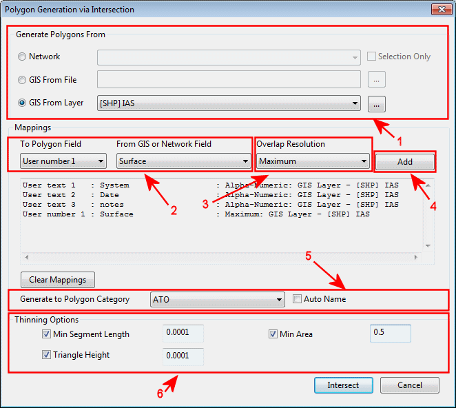

The recommended method of 'cleaning up' problematic IAS data is to generate polygons within InfoWorks ICM, as described in Appendix A.

ERROR: Feature not loaded.
Occurs if the IAS layer is unavailable/read only (for example currently being edited within another package)
ERROR: Invalid SYSTEM field value (id, value): (“Id:UniqueID”, “Text”)
ERROR: Invalid SURFACE field value (id, value): (“Id:UniqueID”, “Text”)
ERROR: Invalid STATUS field value (id, value): (“Id:UniqueID”, “Text”)
The input data has not been recognised. The Unique ID for the polygon and the text that has not been recognised are quoted. Any polygon that has an unrecognised code is ignored.
5.2 Unusual shapes
It is important to investigate errors where shapes are not loaded or warnings where areas are ignored.
These error messages recognise objects that cannot be correctly represented and are therefore not included within the Area Take Off calculations, such as an unrecognised object, a single point or a line.

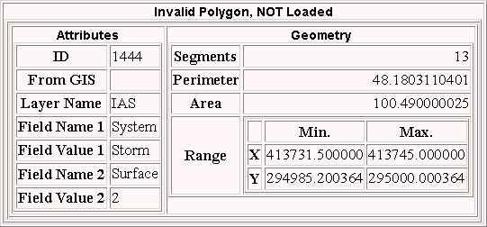

Figure 10 Invalid Polygon Report
The ID either refers to the polygon ID or the row ID of the GIS data source. The x and y Min and Max range provide the geographic co-ordinates to help further identify where the problem shape occurs. These polygons will simply need to be edited.

5.3.1 Overlapping Subcatchments
If two or more subcatchments overlap and a polygon exists on the overlap, provided the relevant system and surface codes apply, the polygon area will be applied to all subcatchments, as shown in Figure 12 below.
Figure 12 Overlapping subcatchments
5.3.2 Overlapping Polygons
For IAS data with the same System Type & same Surface Code, the two areas are merged, as shown below.
Figure 13a Polygons of the same System and Surface
For IAS data with different System Types but the same Surface Code, the overlap is ignored for one of the systems. The one that is retained depends on this order of priority: storm, foul, combined, unknown.
Figure 13b Polygons of the same Surface
For IAS data with different System Types and different Surface Codes, the lowest surface code takes priority (soak aways are considered 0, therefore highest priority.)
Figure 13c Polygons of different System and Surface

This process allows polygons generated in a GIS, to be imported into InfoWorks ICM. This is a very useful half way step because it allows a visual check on how problematic or unusual shapes are being interpreted. Generating polygons via intersections enables overlapping areas to be resolved, the cleaning of data and the option to intersect more than 1 GIS file or network object. It is particularly important for multipart shapes to be imported via this process.
Figure A.1. Intersection Dialog
The following bullet points describe the items identified in the intersection dialogue above.
- The first step is to choose the source from which to generate your polygons from. The source may be a GIS file, a layer or a network subcatchment or polygon
- Choose the polygon user text or user polygon fields to be populated and match this to the field from the source data that shall be copied across.
- From overlap resolution drop down list choose which field value is to be used in cases where overlaps occur. The diagram below shows the different options available for the User number and user text fields.
Figure A.2. Overlap Resolution Options
- In order to intersect chosen source a mapping must be Added, when a field is mapped the information is shown in the mapping list box below.
- Polygons need to be associated to a polygon category. Either select a predefined category or auto name categories. Auto name generates categories OVERLAP_X, where X is the number of overlaps in data from which the polygon is generated.
- Applying thinning criteria to the data may clean the polygon data to improve performance time and reduce unusual shape errors.

A GIS layer may be intersected by a polygon that may represent the model area or the network subcatchment.
For example intersecting an IAS layer with Subcatchments:
After assigning the IAS data above change the source type to Network and select Subcatchment. Map an unused user text field to the Subcatchment ID and select ADD.
Figure A.5. Intersection of Polygons and Subcatchments

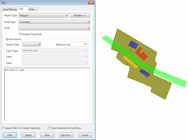

Ensure there are no null fields in any relevant column of the IAS data. To check this, conduct an SQL for null fields in the InfoWorks ICM polygon field you have mapped the IAS data to. Delete any of these null fields.
Figure A.6. SQL to Identify Null Fields

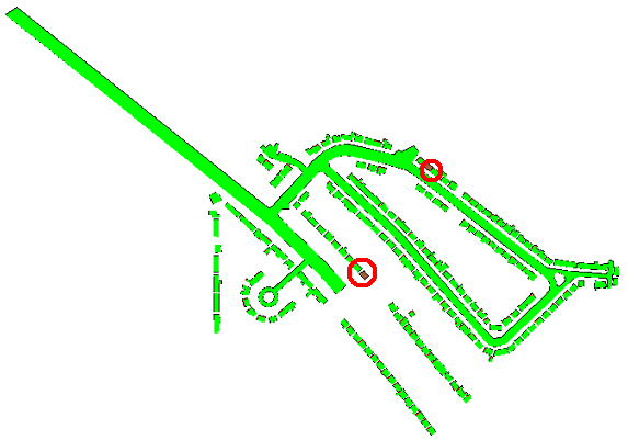

How to Identify Invalid IAS Data
Figure A.7. Invalid IAS Areas Identified.
By filling the polygons a different colour to your back ground map you will be easily be able to identify any unusual shape polygons that have failed to import.
The quickest solution is likely to redraw these polygons within InfoWorks ICM or re-import using stricter thinning options or these polygons can be altered in a GIS package. Error messages in the log will also help identify the location of these errors
