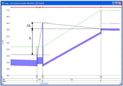

- The pipe area is significantly increased and therefore the flow velocity significantly decreased. This means that the headlosses associated with pipe roughness and minor losses such as bends and junctions, which are all a function of velocity, are under predicted. This is particularly important at pumps, where the head in the head / discharge relationship is defined by both the vertical distance the water must be raised and the additional head required to overcome the losses in the forcemain. This is shown in Figure 2.
Figure 2: Head through which pumped flow must be raised

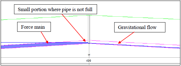

The first limitation of the pressure model is that at the top (most downstream end) of a forcemain the water may not reach the pipe soffit. This is shown in Figure 3.
Figure 3: Top of rising main with pressure model
Due to this small portion of non-pressurised pipe, the pipe cannot be considered full all the time and therefore the pressure model is abandoned for the rest of the simulation and the equation system reverts to the Preissmann Slot approximation. In the past, several workarounds to this have been suggested such as the use of weirs and also lowering of the pressurised pipe, to ensure it is always full.

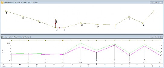

Figure 4 shows a fairly complex forcemain example. Nodes A to C and the pipes associated with them represent a gravity system draining down to a pumping station. Node D is the pumping station wet well which pumps forward to node F. There is an emergency overflow to node E. Node F down to the outfall at node L represents the forcemain traversing a series of hills with all pipes using the forcemain solution and all nodes specified as break nodes. This arrangement is complex to model because pressurised pipes which flow downhill are in danger of not remaining full throughout the simulation.
Figure 4: Forcemain example

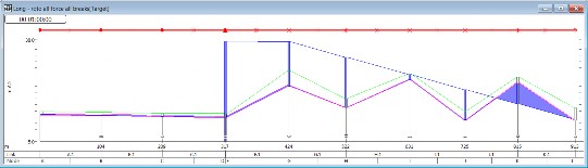

Figure 5 shows the hydraulic profile when the pump is running.
Figure 5: Forcemain in operation
Note the hydraulic profile at node K. Here the hydraulic grade line is well below the pipe level. This part of the system is acting as a siphon.

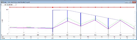

Figure 6 shows the hydraulic profile for this configuration, measured at the same point in the simulation.
Figure 6: Forcemain without siphoning effect
It can be seen that the hydraulic grade line in Figure 6 is greater than in Figure 5. This is because the water has to be pumped up and over the hills without assistance from the siphoning effect.

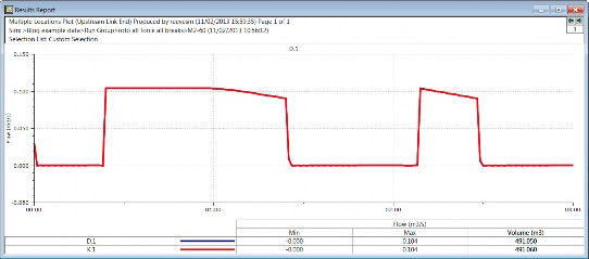

Figure 7 shows a comparison of the flow in the pump (link D.1) with the flow at the downstream end of the forcemain (link K.1) for the siphoning effect shown in Figure 5.
Figure 7: Forcemain flow results
The main thing to notice about the plots is that they are virtually identical, there is no attenuation along the forcemain.

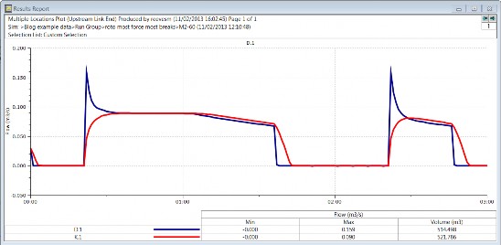

Figure 8 shows the same comparison of pump and forcemain flows for the example shown in Figure 6, where air valves have been included.
Figure 8: Forcemain flow results, air valves included
Comparison with Figure 7 shows that the pump characteristics have changed significantly and there is now significant attenuation along the forcemain. Figure 8 also shows that there is slightly more flow at the downstream end of the forcemain than through the pump. This is because levels are slightly lower at the end of the simulation than at the start. It is not something to be concerned about.
