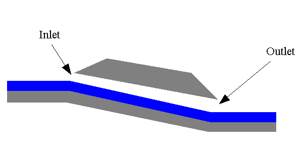

A culvert is typically used to route flow underneath a structure such as a major road, it usually consists of a an inlet structure to 'funnel' the flow into a concrete channel and then out via a similar outlet structure. Several examples and photographs of culverts are presented in Reference 1.
Figure 1 Schematic Long Section (Profile) of a Culvert

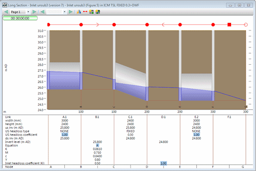

A typical culvert arrangement is presented in Figure 2 below.
Figure 2 Representation of a Culvert
A.1 is the upstream channel, B.1 is the culvert inlet, C.1 is the culvert itself, D.1 is the culvert outlet, E.1 is the downstream channel and F.1 is a weir, which is simply applied in order to raise the downstream water level and is not usually required in culvert design (in this analysis it is not used at all.)
All coefficients must be specified even if the flow conditions mean that they will not be used.

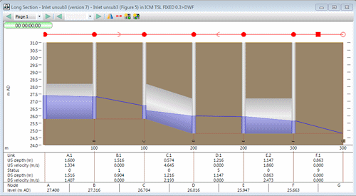

3.1 Super-critical and Un-submerged, Equation A
This example uses the network shown in Figure 2 and a constant inflow of 6.4 m3/s.
The results are presented in Figure 3.
Figure 3 Super-critical, un-submerged, Equation A

The culvert inlet has a stats of 1, which matches the condition presented in Table 1.
Assume that the inlet is 90 and 15 degree rectangular concrete wingwalls. The coefficients to be used are presented in Figure 2.
From equation 5:
therefore Ac = 2.15 |
therefore yc = 2.15/2.4 = 0.898 m vc = 6.4/2.15 = 2.976 m/s |
From equation 4:
From equation 3:
Therefore HWi = 1.516 m.
From Figure 3 it can be seen that the water depth at the downstream end of the channel (link A.1) is 1.516 m.
3.1.2 Culvert Headloss Calculations
To solve equation 11:
From Figure 3 it can be seen that Vuc = 1.407 m/s.
Assume that the bars cover 20% of the available area, therefore:
VS = 1.407 / 0.8 = 1.759 |
Taking a value of kb of 0.214 from Design Chart D5 of CIRIA (Ref 1) and solving equation 12, gives a value of hb = 0.213m
Therefore from equation 10, hT = 0.213 + 0.085 = 0.298 m.
Solving for K in equation 9 gives:
Therefore K = 0.3, which is applied to the upstream end of the culvert as shown in Figure 2.
The results in Figure 3 show that the depth at the upstream end of the culvert (link C.1) is 0.574 m. The culvert invert level is 25.80 m. Therefore the water level at the upstream end of the culvert = 26.374 m. From Figure 3 it can also be seen that the water level in the manhole immediately upstream of the culvert (node C) is 26.704. Therefore the headloss calculated by InfoWorks is 26.704 – 26.374 = 0.330 m.
From the standard head loss equation 9:
This matches the model results.

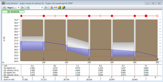

3.2 Super-critical and un-submerged, Equation B
In this example only the inlet calculations are presented as the culvert and outlet are the same as presented in Chapter 3.1.
This example uses the networks shown in Figure 2 and a constant inflow of 6.4 m3/s. Values of K = 0.515 and M = 0.667 are used, which are consistent with Table D.1 of Reference 1.
The results are presented in Figure 4.
Figure 4 Super-critical, un-submerged, Equation B
From Figure 4 it can be seen that the depth at the downstream end of the channel (link A.1) is 1.472 m.

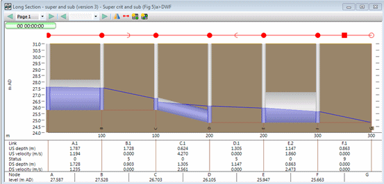

3.3 Super-critical and Submerged
Here only the inlet calculations are shown, because as mentioned previously, the headloss in the culvert itself and the outlet are calculated by the same method as the un-submerged condition. This example uses the same culvert arrangement as shown in Figure 2, except the height fo the culvert is reduced from 2.4 to 1.0 m. Therefore from equation 2:
> 4.0, therefore submerged |
Therefore from equation 7 and Figure 2:
HWi = 1.728 m
From Figure 5 it can be seen that the status of the culvert inlet is 5, matching the condition presented in Table 1. The depth at the downstream end of the channel predicted by the model is 1.728 m, this matches the manual calculations.
Figure 5 Super-critical Submerged Condition

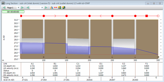

3.5 Sub-critical (Equation 8 dominating)
This example matches that presented in Chapter 3.4 except the headloss at the upstream end of the culvert (link C.1) is increased from 0.9 to 1.5. The results are presented in Figure 7.
Figure 7 Sub-critical Condition Outlet Control Dominating
The calculation of HWi is unaffected, remaining at 1.527 m.
Outlet control
From equation 9:
Therefore level at upstream end of culvert (node C) equals:
Invert + upstream depth + headloss = 25.8 + 1.21 + 0.371 = 27.381 m, which matches the result presented in Figure 7.
Therefore the velocity at the downstream end of the inlet equals:
Q/A = 6.4/(1.21 + 0.371)*2.4 = 1.687 m/s
Therefore, from equation 8:
Therefore HWo = 1.21 + 0.371 + 0.073 = 1.654 m
Now HWo > HWi and therefore HWo dominates.
The value of HWo matches the upstream depth in the inlet (link B.1) presented in Figure 7.
Note that the status of the culvert inlet is now 9.
