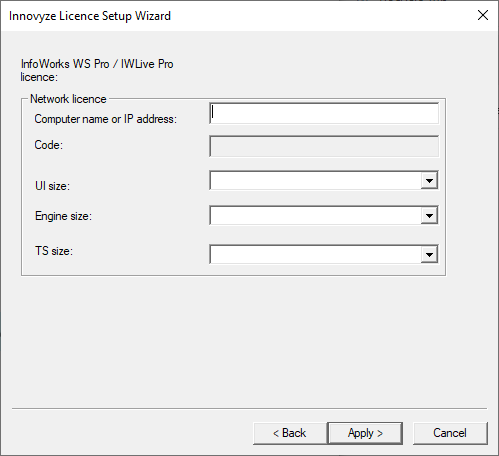

The Settings Page of the License Wizard is used as part of the process of setting up the Innovyze license to be used by users on a client PC.
If selecting a network type license, enter network license details:
  • Computer name or IP address - The name or IP address of the Innovyze license server. If you have previously provided this information, it will be displayed in this field.
  • Code - A read-only field that displays the code for the selected UI/Engine/TS size.
  • UI size - Allows you to choose from a drop-down list, the maximum number of nodes / elements that can be used in IWLive Pro Operator Client using the specified Innovyze license. You should ensure that this is set to the appropriate UI size for your Innovyze license.
  • Engine size - Allows you to choose from a drop-down list, the maximum number of nodes / elements that can be processed by the IWLive Pro Operator Client engines using the specified Innovyze license. You should ensure that this is set to the appropriate Engine size for your Innovyze license.
  • TS size - Allows you to choose from a drop-down list, the maximum number of nodes / elements that can be used in IWLive Pro Operator Client using the specified Innovyze license. You should ensure that this is set to the appropriate TS size for your Innovyze license.
Click the Apply button to apply the settings. If the update is successful, the Finish page will be displayed.
