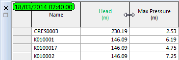

Changing column width
- To change the width of a column, drag the divider line on the right of the column header.
If this option is allowed, the cursor will change as shown on the image when over the column divider.

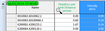

Changing column order
On some grids, changing column order is allowed.
- Select
a column and drag it to a new position.
If the position is valid, the dividing line between columns where the dragged column will be inserted is displayed as a thick grey line.
If the position where you want to drop is invalid, the
cursor will be displayed.
The image shows a valid drop position for the selected Velocity column.
