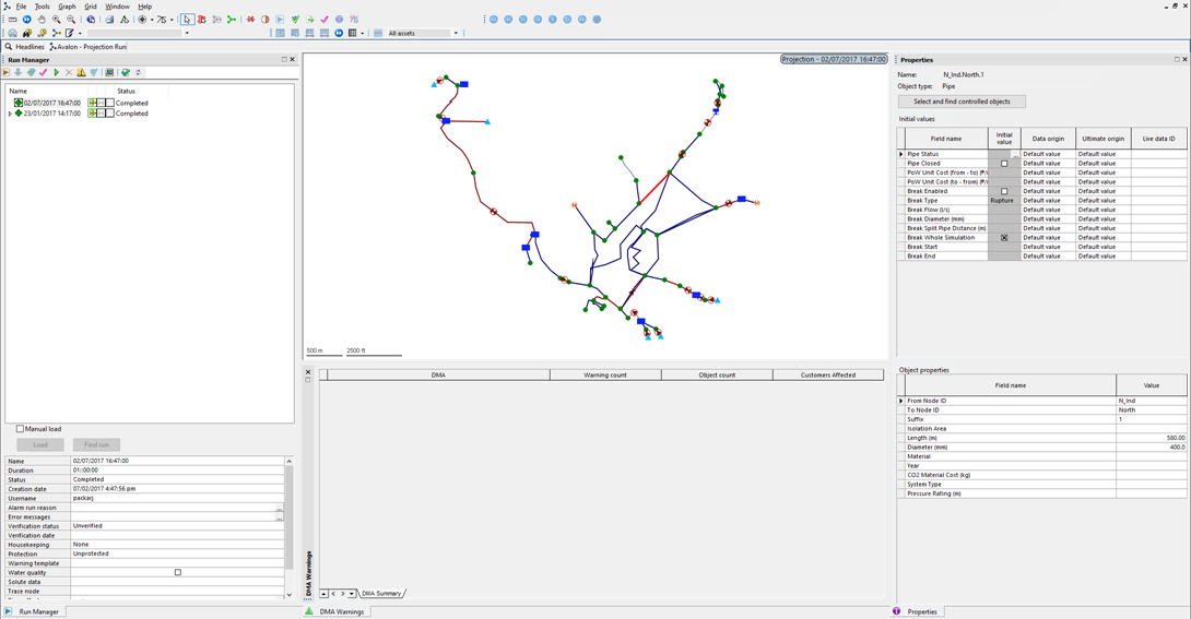

The Map view displays a detailed map of the network belonging to an individual baseline. All network objects are displayed in the map view.
  • Click an object in the map view using the Selection tool tool to select the object. Hold down the Ctrl key to select multiple objects.
  • Click an object using the Properties tool to display the property sheet for an object.

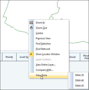

  • Right click the map to display a context menu containing options to control the map display.
  • Additionally the view Zone context menu option of the Map view is available if zones have been defined for the baseline.This option lists all the zones present in the baseline. Select a zone from the list to zoom the Map view to that zone.
View Zone context menu option
