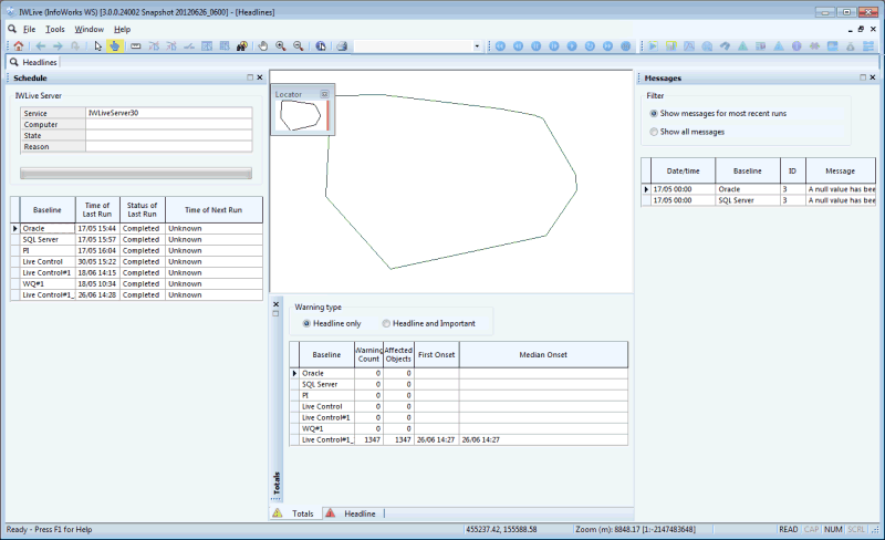

The Headlines page in the Operator displays an overview map of all saved and enabled baselines.
The Map view displays a polygon for each baseline either generated from the network extents or user-defined. Each polygon is coloured according to the warning theme selected in the GeoPlan Properties & Themes in the Administrator mode. Background GIS Layers displayed on the Map view are specified by selection of a layer list in GeoPlan Properties & Themes.
  • Click an area in the map view using the Selection tool tool to select the object. Hold down the Ctrl key to select multiple areas.
  • Click an area using the Properties tool to display the property sheet for an object.
  • Click an area using the Open associated item tool to display the Baseline view for the baseline associated with the polygon. If more than one baseline is associated with the polygon, a Multiple Selection dialog will be displayed listing all of the associated baselines; select the baseline to be displayed and click the OK button.
  • Right click the map to display a context menu containing options to control the map display.
See the Map view section for further details on using the map view.
