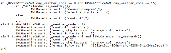

About the switch configuration script language
Ruby scripts are written to define when switch objects are to be used based on weather feed data and date.
An example of a script is shown below:
