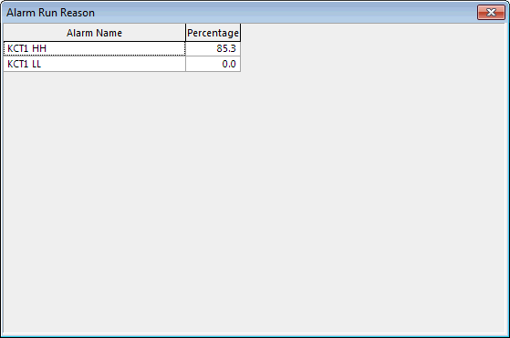

Alarm Run Reason grid
The Alarm Run Reason grid is displayed when the Ellipsis button button adjacent to the Alarm Run Reason property is clicked on the Run Manager for the current run.
Run Reason Grid
The Alarm Run Reason grid shows the reason why the currently selected run has been triggered. The reason comprises the two following parameters:
  • Alarm Name - Name of the alarm(s) that has (have) triggered the run.
  • Percentage - This field indicates how long the corresponding alarm has been on within the time window and is expressed as a percentage of the total time of the time window.
SCADA alarms are set in the in the Trigger Feeds page of the Baseline, either in InfoWorks WS Pro or in the Administrator mode.
Please note that the grid is read-only.
Tip:
The grid will be empty for incident and response runs, as well as for normal projection runs (i.e. runs that are not triggered by SCADA alarms).
