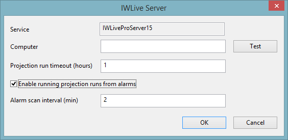

The IWLive Pro Server dialog is used to test the status of the IWLive Pro Server windows service. When the server information is configured, the Schedule page (present in bothIWLive Pro Operator and IWLive Pro Administrator mode will display status information.
The dialog is displayed when the Configuration | IWLive Pro Server menu option is selected in the Administrator mode.
| Option | Description |
Service |
Read-only. Automatically populated with the service name. |
Computer |
Name of the computer on which the IWLive Pro Server service is installed. |
Test |
Click this button to test the status of the service on the specified computer. A message will be displayed indicating the status of the service, e.g. running, stopped, server unavailable. |
Projection run timeout (hours) |
Maximum length of time a projection run is allowed to run for before the simulation is aborted. |
Enable running projection runs from alarms |
Tick this check box to enable projection runs to be triggered by SCADA alarms. |
Alarm scan interval (min) |
Available when the Enable running projection runs from alarms option is enabled. Frequency in minutes at which the occurrence of alarms is checked by the IWLive Pro server. Default is 2 minutes. |
OK |
Commit the changes and close the dialog. |
Cancel |
Abort the server configuration process and close the dialog. |
Once the server is configured in this dialog, its details will be displayed in the Headlines Schedule window.
