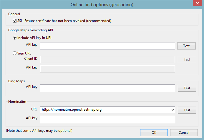

Online Find Options (Geocoding) dialog
The Online Find Options (Geocoding) dialog is used to specify the web map applications that are to be used for geocoding (converting addresses into geographic coordinates) and reverse geocoding (using geographic coordinates to find a location, usually a postal address). In order to access these applications, a connection to the Internet is required and you may need to know the Application Programming Interface (API) key(s) supplied to your company from the relevant web map application provider(s).
The Find (Find) and the Go to XY coordinates(Go To XY Coordinates) options, accessed from the toolbar or Window menu, can be used to search using an address or co-ordinates, according to the geocoding options specified in this dialog.
The dialog is displayed when the Online find options (geocoding) button is clicked in the Geoplan page of the Options dialog.
Online Find Options (Geocoding) Dialog
Option Description
SSL
Select this box to indicate that IWLive Pro Operator Client must check that Secure Sockets Layer (SSL) encryption certificate is valid.
A valid certificate should indicate that access to the site is secure.
Google Maps Geocoding API
Access to the web map application provided by Google™ can be specified using either of the following options:
Option
Help Text
Include API key in URL
The API key field is enabled allowing you to specify the key assigned by Google™ to your company.
Sign URL
The Client ID and API key fields are enabled allowing you to specify the Client ID and API key assigned by Google™ to your company.
Bing Maps
Access to the web map application provided as a part of Microsoft™'s Bing suite of search engines can be specified by entering the key supplied by Microsoft™ in the API key field.
Nominatim
Access to a Nomination (a search engine for OpenStreetMap data) application provider is set up by specifying the following:
Field name
Help Text
URL
The Uniform Resource Locator (URL) for the Nominatim provider can be selected from the drop-down list.
API Key
The API key assigned by the Nominatim provider to your company.
Test
Test that the site can be accessed using the specified information, and the length of time (in seconds) taken to access the site.
OK
Commit the changes and close the dialog.
Cancel
Abort the geocoding configuration.
Select the desired web map application to be used by completing the appropriate fields. Click Test to test that the connection is working and then click OK to save the changes.
