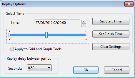

Replay Options dialog
The Replay Options dialog is displayed by clicking the Jump to / Replay options button on the Replay toolbar. The dialog allows:
  • Selection of a particular time in a simulation so that results can be viewed at that point
  • Selection of the start and finish time of the replay so that a shorter section of the simulation can be viewed
  • Application of the selected start and finish times to results graphs and grids
  • Adjustment of the replay speed of the simulation
The current simulation time is shown in the Time box.
Set the current simulation time by moving the slider bar or using the up and down arrows next to the Time display.
Change the start and finish time for replays by setting the current simulation time and then clicking the Set Start Time or Set Finish Time button. On the slider control, the time limits of the current replay are shown in blue. Any parts of the simulation that fall outside the current replay are shown in white.
To remove any changes that have been made to the time selection and set the replay start and finish time back to the start and finish time of the simulation, click the Clear Settings button.
Check the Apply to Grid and Graph Tools option to apply the selected start and finish times to results graphs and grids.
To adjust the replay speed of the simulation, use the Replay delay between jumps dropdown.
When OK is clicked, the simulation will be paused at the current simulation time shown in the Time display. All the views of the simulation are updated to show the current state of the network at the selected time.
