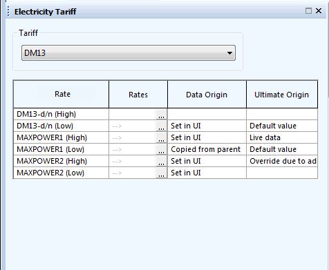

The Electricity Tariff window allows the viewing and editing of electricity tariffs for the run currently selected in the Run Manager. By default, the window is displayed on the left hand side of the Baseline Page.

Electricity Tarrif Window
Option Description
Tariff dropdown list
Contains the electricity tariffs associated with the default simulation.
Rate
Lists the individual rates contained in the tariff selected in the dropdown list.
Rates
The Rate Editor can be accessed by clicking the button of the Rates column.
Rates are editable for incident and response runs
Data Origin
Origin of the current data. The value depends on what has been set in the Fields window for the rate of interest, and also on the run type.
Please refer to the Properties Window topic for further information on the Data Origin field, more specifically on the values this field can take.
Incident and Response Runs inherit their rate values from parental runs. Data Origin will by default indicate Copied from parent unless the value is edited.
Ultimate Origin
Origin of the parent data.
For permitted values, please refer to the Data origin field above.
If an incident run has been generated from a projection run,the Data origin field gets populated with Copied from parent and the Ultimate origin will have the same value as the projection run's Data origin field.
When the incident or response run is simulated, the electricity tariff values are applied to the simulation. (The data in the Electricity Tariff window is read-only whenever a projection run is open).
