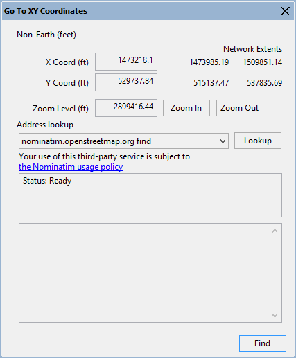

Go To XY Coordinates window
This window allows you to centre the GeoPlan window on a specified point, and zoom in or out on that point if required.
The window is displayed when you click the Find XY button on the Operations Toolbar.
Go to XY coordinates
Field Description
Projection
Read only field telling you the current map projection for the GeoPlan
X Coordinate
Chosen X Coordinate. The default is the centre of the current view.
Y Coordinate
Chosen Y Coordinate. The default is the centre of the current view.
Zoom Level
The selected zoom level. The default is the current zoom level.
Network Extents
The maximum and minimum X and Y extents of the network. For your information.
Zoom In and Zoom Out buttons
Use these buttons to adjust the zoom level. Each click doubles or halves the zoom level.
Address lookup
Lets you look up an address based on the current XY coordinates.
Choose the geocoding service from the drop-down list, then click Lookup.
The status of the search is reported in the upper box.
If there are any search results, they are listed in the lower box.
Find Click to zoom to the XY coordinates or address.
