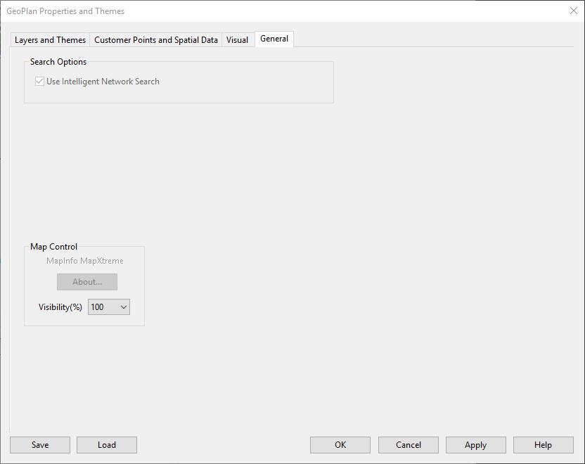

This page shows basic information about the GeoPlan, digitisation modes, and the current map control.
This page is opened by selecting Tools | Properties & Themes, then clicking the General tab.
GeoPlan Properties and Themes - General page
Option
Description
Search Options
Use Intelligent Network Search
Bypasses the display of the Multiple Selection dialog when selecting objects on the GeoPlan where different object types overlay each other.
For example, with this option turned off, clicking a node connected to links will display a selection dialog list of the node and connected links. With this option turned on, clicking the node will select the node only.
Map Control
Map control name (read only) Shows the current map control.
About
Opens the About Box for the current map control.
Visibility(%)
Fades the map background on the GeoPlan.
This setting does not affect printing, in which map backgrounds are always at 100% visibility.
Other controls See GeoPlan Properties And Themes dialog.
