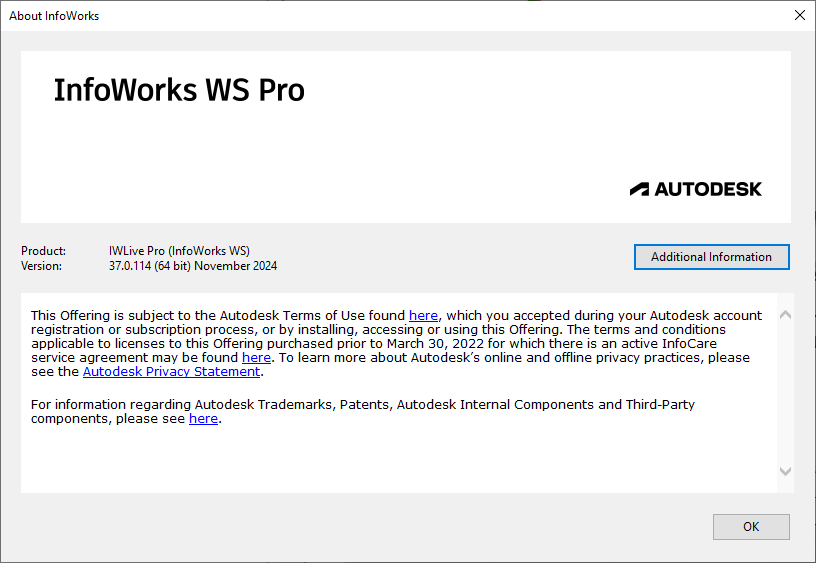

The InfoWorks WS Pro About box displays useful information about your current IWLive Pro Operator Client installation, as well as Privacy and Autodesk Trademarks information.
The About box is displayed by selecting About IWLive Pro Operator Client from the Help menu. The contents of the Additional Information area can be copied to the clipboard.
Clicking the Additional Information button displays the following information:
