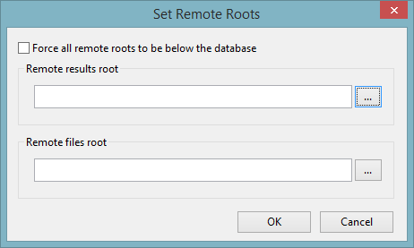

Set Remote Roots dialog
The Set Remote Roots dialog is used to set the directories to which data saved outside of the database will be written.
This dialog is accessible via the Database | Set Remote Roots menu option or the File | Database Administration | Set Remote Roots menu option, depending on the product.
Field Description
Force all remote roots to be below the database
This option is available for JET Standard databases only.
Check this box to store all remote root data in the directory containing the database.
Remote results root
Simulation results saved to the server will be stored in the remote results root.
Enter the path of the directory to be used as the remote results root or use the button to browse for a directory.
Remote files root
The remote files root will be used as the data source file base for live data by default.
Enter the path of the directory to be used as the remote files root or use the button to browse for a directory.
