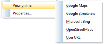

  2. Click the location/ object of interest on the Map view , and select view online from the context menu, then choose the desired map service.
    Tip:
    If several objects are selected on the Map view , only the GPS coordinates of the last object will be used by the online mapping service.
    Online map availability on the Map view context menu is configured in the Online Map Options dialog. Supported types include:
    • Google™Maps
    • Google™ Street view
    • Microsoft™ Bing
    • OpenStreetMap
    • User-defined URL

    Map View context menu

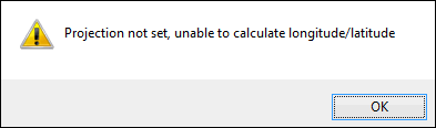

  3. If no coordinate system has been set, a warning message will be displayed. In this case, click OK on the message, set an alternative coordinate system, then restart the procedure from step 1.
  4. Tip:
    For MapObjects and MapX map controls, and i f no map control has been specified - it is essential to manually set an online map projection system to be able to use web mapping software.
    Show me
    Projection not set message

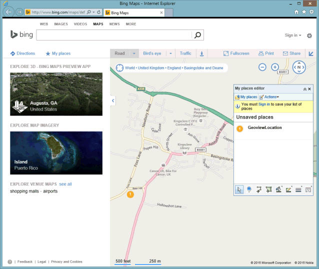

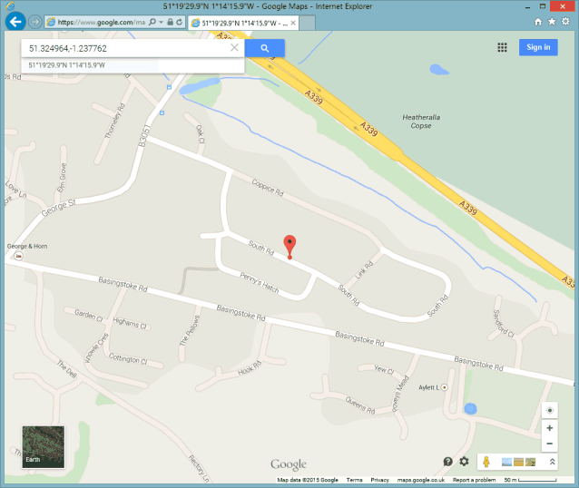

If no warning message similar to the one described above is displayed, the selected web mapping software is launched using the default browser. The map opens with the location/object corresponding to the GPS coordinates that have been clicked on the Map view highlighted on the map. By default, the map will be centred on these coordinates.
Show me GoogleMaps example
GoogleMaps example
GoogleMaps
Show me Microsoft Bing example
Microsoft Bing
