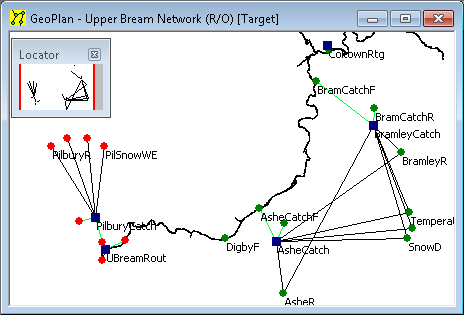

  • When you click an object it turns red; to select several objects, hold down the Ctrl key as you click them.
  • Clicking an object a second time with Ctrl held down removes it from the selection.
    GeoPlan multiple selection
  • To clear the current selection, click a blank area of the GeoPlan.

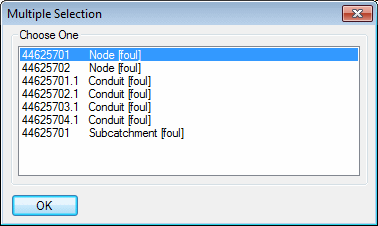

  • If you are close to more than one object, the Multiple Selection dialog is displayed, showing the labels of the nearest objects. Click one of these and then on OK to display the appropriate property sheet.
    Multiple Selection

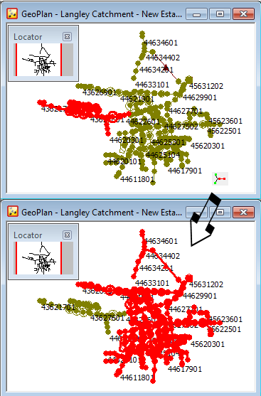

Invert Selection
Invert selection Invert the current selection. This functionality is also available via the Selection menu.
