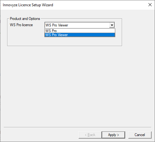

This page of the License Wizard is used to choose the license(s) used by the current user and therefore the options available to the user in those applications.
It is displayed when the Choose the InfoWorks WS Pro licenses to use option is selected on the Welcome Page of the license wizard.
The WS Pro License choices are:
- WS Pro - allows access to model groups; users can create and work with any objects in these, including InfoWorks networks, event data and other modelling prerequisites. Users may operate in a workgroup setup, allowing for concurrent model access and editing as well as submission of simulations to any available WS Pro agents in the workgroup.
- WS Pro Viewer - allows access to model groups and have a read-only view of InfoWorks networks. Users have a read-only view onto objects such as InfoWorks networks, controls, and other modelling prerequisites. Users do not have the ability to run and re-run simulations.
All license choices will appear in the list regardless of availability.
Click the Apply button to apply the settings. If the update is successful, the Finish page will be displayed.
