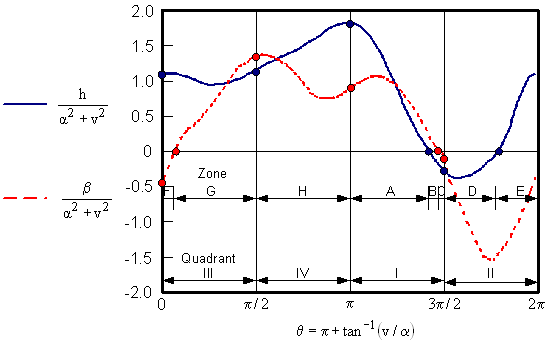

An example curve is shown below. Curves of h/(α2+v2) and β/(α2+v2) are plotted, where:
h = H/HR = Actual Head / Rated Head
v = Q/QR = Actual Flow / Rated Flow
α = N/NR = Actual Speed / Rated Speed
β = T/TR = Actual Torque / Rated Torque
The curves are plotted over a range of 0 to 2π using 89 data points at intervals of π/44 radians.
Four Quadrant Curve Example
Quadrant | Zone | Flow (v) | Speed (a) | Head (h) | Torque (w) | Definition |
I | A | + | + | + | + | Normal pumping |
I | B | + | + | - | + | Energy dissipation |
I | C | + | + | - | - | Reverse turbine |
II | D | + | - | - | - | Energy dissipation |
II, III | E | ± | - | ± | - | Reverse rotation pumping |
III | F | - | - | + | - | Energy dissipation |
III | G | - | - | + | + | Normal turbine |
IV | H | - | + | + | + | Energy dissipation |
Table 1: Pump Operating Zones and Quadrants
