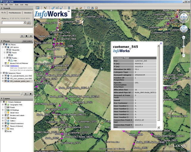

The Nodes are all clickable to reveal a balloon pop-up table of the node data. Each link has a smaller dot icon half way along: this can be clicked to bring similar information for a link.
If the network has some results then the results for the node or link will be displayed on the "balloon" table when their icon is clicked.
Customer points appear in Google Earth as a small rectangular icon about 20% of the area of a normal node icon. Customer points are in the same colour as specified in the GeoPlan.
WS network in Google Earth
