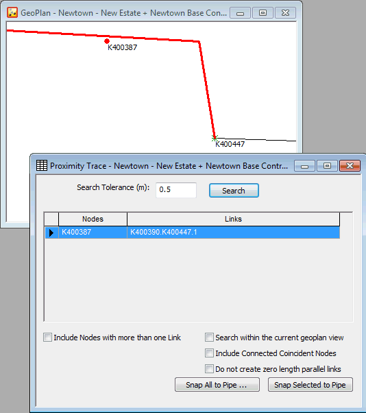

Carrying out a Proximity Trace
  1. With a network open, choose GeoPlan Tracing tools Proximity trace. This will display the Proximity Trace View. If you want to make subsequent changes to the network, it must be checked out.
  2. Set a Search Tolerance value. The default is 0.5 metres. If you want, you can carry out a trace with the default value, and then carry out further traces with higher values if needed.
  3. Select nodes to be included in the search by using the check box options:
    Include Nodes with more than one Link
    By default, only disconnected nodes and nodes connected to a single link will be included in the search.
    Check the Include Nodes with more than one Link box to include nodes connected to more than one link.
    Search within the current geoplan view
    By default, the entire network will be searched.
    Check the Search within the current geoplan view box to only include nodes currently displayed in the geoplan.
    Include Connected Coincident Nodes
    By default, coincident nodes connected by a link will not be included in the search.
    Check the Include Connected Coincident Nodes box to include coincident nodes connected by a link. This option is particularly useful when importing objects from GIS which are represented as nodes in GIS, but as links in InfoWorks (for example, valves).
  4. Check the Do not create zero length parallel links option to avoid creation of a pipe with length of zero when coincident nodes connected by a link are snapped into a pipe. (For example, this option should be used when snapping in valves that have been imported from GIS point data. By default, when the second node of the point valve is snapped into the pipe, a zero length pipe parallel to the valve is created. If the Do not create zero length parallel links option is checked, the zero length pipe will be discarded.)
  5. Click the Search button to list un-connected nodes that lie within the Search Tolerance distance of another pipe and match the criteria selected above.

To automatically snap all nodes detected by the Proximity search to pipes
  1. Click the Snap All to Pipe button. The Move Node dialog will be displayed.
  2. Select a flag for new link lengths if required.
  3. Use the buttons at the bottom of the dialog to select action to be taken for each node:
    • OK All - Snaps all of the nodes found in the proximity search to adjacent pipes.
    • OK - Snaps current node to adjacent pipe. The Move Node dialog for the next node in the Proximity Trace list will be displayed.
    • Cancel - Current node is not snapped to pipe. The Move Node dialog for the next node in the Proximity Trace list will be displayed. If OK All is clicked after cancelling, only nodes after the current node in the list will be processed.
Each node displayed in the grid on the Proximity Trace View is snapped to its adjacent pipe at the nearest point on the pipe. When using OK All, the node will be snapped to the first pipe in the Split Existing Link list.
