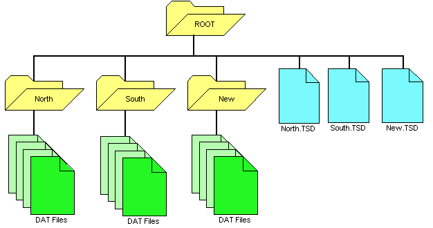

Figure 1 below shows the file and folder structure. For each TSD file there is a sub-folder with the same name (without the .tsd extension). The associated DAT files are stored in this sub-folder.
Figure 1: Time Series Data File and Folder Structure
