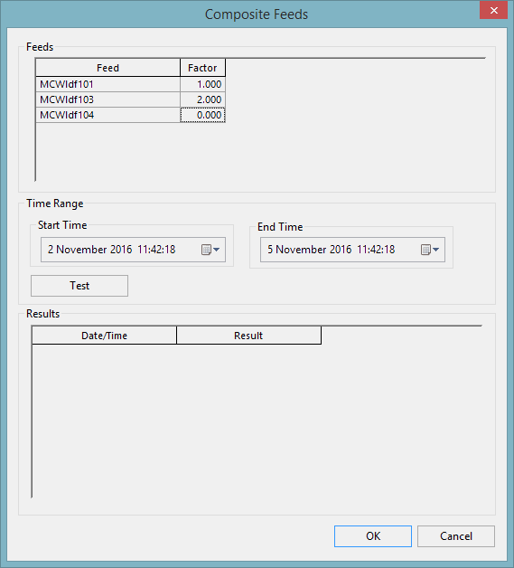

Composite Feeds dialog
The Composite Feeds dialog can be used to combine feeds into composite feeds. A number of primary feeds are combined by addition and subtraction, by using a multiplier factor. Interpolation is used if time steps do not coincide.
To display the dialog:
  • Right-click a feed name or feed count in the Live Data Composite Feed view and select Feeds from the context menu.
  • Right-click a feed name or feed count in the Live Data Composite Feed view and select Properties from the context menu. In the Live Data Composite Feed object properties window, select Feeds.
Field Description
Feeds
Feed - This column contains the list of available feeds, as specified in the Live Data Feed View.
Factor - Enter multiplier factors for each feed to determine the composition of the composite feed.
Time Range
Start Time and End Time - Specify date/ time range over which the enabled feeds are to be tested for.
Test - Click this button to test the composite feed with live data. The results will be displayed in the Results grid.
Results
Displays a grid with the returned results for the time period set in the Time Range section.
OK
Click to close the dialog.
