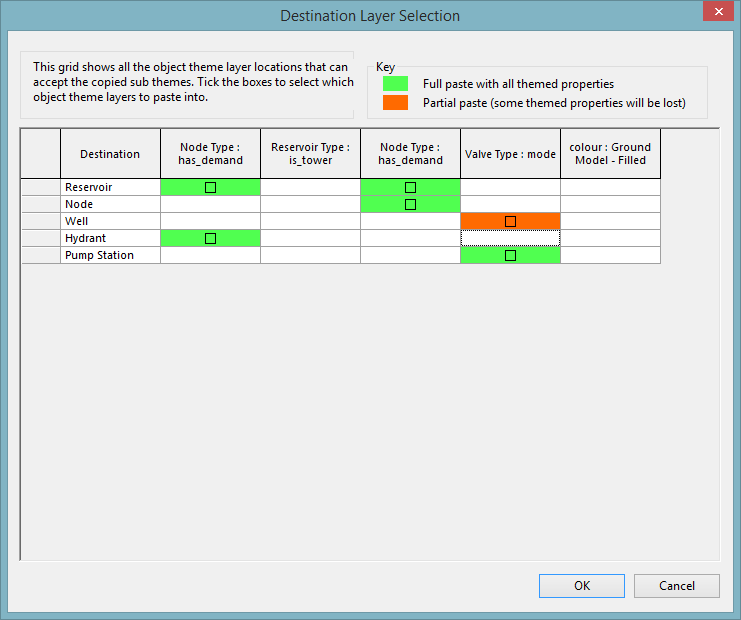

Destination Layer Selection dialog
This dialog is used to copy sub themes across object layers. The copied sub themes will be added to the destination object layers and will appear in the Layer Theme Editor dialog.
The dialog is displayed when the OK button of the Copy Sub Themes dialog has been clicked.
Destination layer selection
Item Description
Grid Shows the destination object layers that are compatible with the fields of the themes that have been selected to be copied. If there are no checkboxes shown in the grid, there are no compatible destination object layers.
Checkboxes Tick the box for each object layer you want to copy the sub themes into. Note the explanation of the cell colours.
