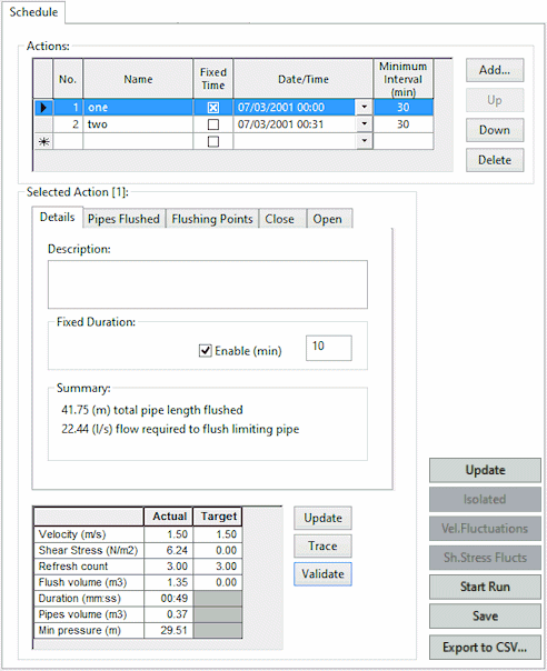

This page is divided into three sections:
- Actions: lists the actions in the schedule and lets you add, delete, and reorder them
- Selected Action: details
the current action and provides validation and additional information for
each action
- Schedule buttons: lets you control, start, and save the schedule
The page is opened by clicking the Schedule tab on the Flushing Scheduler.
Show image
Actions section
This section contains a grid of the actions in the schedule.
The buttons by the side of the grid are used to add, delete, and edit the
order of the actions.

Selected Action section
This section contains a number of tabs that display details
of the action currently selected in the Actions grid. The buttons below
the tabs are used to provide validation and additional information for
each action.
Item |
Description |
Tabs |
Details
This tab is used to add text describing
the currently selected action and to specify a fixed duration for the
action.
Description
Notes for the currently selected actions.
Fixed Duration
If the Enable box is checked, you can enter the number of minutes
for which the action is to be carried out.
Summary

Summary values grid |
Grid displaying summary values for currently selected action.
Velocity |
The lowest velocity of water through pipes when flushing is carried out is reported as Actual velocity.
This cell will be highlighted pink if the Actual velocity is lower than the Target velocity, which is set in the Minimum required velocity field on the Criteria & Hydrants page.
Shear Stress |
The lowest shear stress through pipes when flushing is carried out is reported as Actual shear stress.
This cell will be highlighted pink if the Actual shear stress is lower than the Target shear stress, which is set in the Minimum required shear stress field on the Criteria & Hydrants page.
Refresh count |
The lowest number of times the water in a flushed pipe was refreshed is reported as Actual refresh count.
This cell will be highlighted pink if the Actual refresh count is lower than the Target refresh count, which is set in the Refresh count field on the Criteria & Hydrants page.
Flush volume |
Volume of water used to carry out flushing action is reported as Actual flush volume.
This cell will be highlighted pink if the Actual flush volume is greater than the Target flush volume, which is set in the Maximum flush volume field on the Criteria & Hydrants page.
Duration |
Time taken to carry out flushing action. |
Pipes volume |
Volume of pipes to be flushed. |
Min pressure |
Minimum pressure in the network for demand nodes (excluding reservoirs and nodes having only leakage loss). |
Selected Action buttons |
Trace
Enabled when a single action
is selected and a flushing simulation has been specified.
Clicking this button highlights (on the GeoPlan) pipes flushed, flushing points, and links
to be closed.
Validate
action is selected and a flushing simulation has been specified.
Clicking this button validates the currently selected action. Validation
messages will be displayed in a Warnings and Errors box.
Update
Can be used to:
- recalculate non fixed action start time and duration
- flushing point flows
- flushed pipe velocities, flows, and flushing times
Isolated
Clicking this button displays (on the GeoPlan) nodes that will be isolated during the
Schedule buttons
The buttons to the right of the Selected Action section apply to the
whole schedule.
Button |
Description |
Update
Enabled when a flushing
simulation has been specified on the Simulations page.
Can be used to:
- recalculate any non fixed action start times and
durations for all actions in the schedule
- check for excessive velocity fluctuations in un-flushed
pipes (if a base simulation has been specified on the Simulations page)
Isolated
page.
Selects isolated nodes on the GeoPlan.
Vel.Fluctuations
simulation and a base simulation have been specified on the Simulations
page, and velocity fluctuations above the minimum specified
on the Criteria
& Hydrants page have been found.
Selects the pipes with excessive velocity fluctuations on the GeoPlan.
Sh.Stress Flucts |
page, and shear stress fluctuations above the minimum specified
on the Criteria
Selects the pipes with excessive shear stress fluctuations on the GeoPlan.
Start Run
page.
Saves any changes that have been made to the schedule,
and runs the flushing simulation.
Save
Saves changes to the
schedule.
Export to CSV |
For exporting the flushing schedule data to one or more comma-separated values files.
Opens the Select CSV Export Options dialog (with the option to export each table to the same CSV file or to export each table to a different CSV file), and subsequently a standard Save As dialog for choosing the name and location of the saved CSV file(s).
