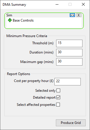

The Demand Management Area (DMA) Summary dialog is used to produce a grid report of failures that meet a defined minimum pressure criteria for a selected simulation. The dialog is displayed when Results | Grid reports | DMA Summary is selected in the Results menu.
| Item | Description |
| Sim[ulation] |
For identifying one or more simulations to base the report on.
| Minimum Pressure Criteria |
Threshold: Calculated from the base simulation. The lowest pressure experienced at the customer point for at least the specified duration. Duration: The minimum time period during the simulation when the lowest pressure is experienced. Maximum gap: If pressure goes above the Threshold criteria for less than the time period specified in the Maximum gap, it will be counted as a failure. If pressure goes above the Threshold criteria for more than the time period specified in the Maximum gap, it will not be counted as a failure. |
| Report Options |
When selected, these attributes will be included in the report. Cost per property hour: Cost for every property hour when the Minimum Pressure Criteria for a property is not met. Selected only: Allows you to apply to selected customer points only. Detailed report: Allows you to generate a detailed report in DMA Summary View. Select affected properties: Allows you to select the affected properties in the GeoPlan. |
| Produce Grid | Generates the report. For more information, refer to DMA Summary View. |
(Browse) button to search for a simulation.
(Delete selection) button can be used to delete items from the box.
