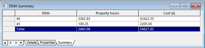

This view provides details of failures that meet a defined minimum pressure criteria for a selected simulation.
The view is displayed by selecting
Results
Grid reports
DMA Summary, then completing the
DMA Summary dialog , and then clicking the
Produce Grid button. The fields displayed in the report will depend on the report options selected.
| Item | Description |
| Summary tab |
DMA: Demand Management Area (DMA) ID. Property hours: Total number of property hours (Number of properties multiplied by the Duration) for a particular DMA. Cost: Total cost (Property hours multiplied by the Cost per property hour) for a particular DMA. |
| Properties tab |
DMA: Demand Management Area (DMA) ID. Properties: Number of properties for a certain duration. Duration: Total duration during the simulation when pressure dropped below the threshold. Property hours: Number of Properties multiplied by the Duration. Cost: (Property hours multiplied by the Cost per property hour) (specified in DMA Summary dialog). |
| Details |
Customer: Name ID of the customer where the Minimum Pressure Criteria is experienced. Start Time: Start time when the pressure is below the threshold as specified in the Minimum Pressure Criteria. End time: End time when the pressure is below the threshold as specified in the Minimum Pressure Criteria. |
| Context menu |
Sort ascending/descending: Allows you to sort the data in the report in ascending or descending order. Export CSV report: Allows you to export the report to CSV format. Select and find in GeoPlan: Allows you to select and locate the affected properties in the GeoPlan. |
| Column order |
You can change the column order by selecting a column and dragging it to a new position. If the position is valid, the dividing line between columns where the dragged column will be inserted is displayed as a thick grey line. |
