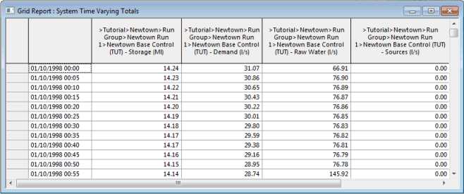

This report displays a series of time varying totals, with one row per model timestep.
The report is opened by selecting Results Grid reports Flow, system and global summary results and then completing the Grid Report dialog, choosing System as the report type.
Item Description
Column headers Contains the full database location of the simulation (model group, run group, run, simulation). May also contain the title of the data in the column as the final element.
System report columns
Storage: The total storage in the model (total volume in reservoirs).
Demand: Total demand from the model. This is the sum of Consumption, Transfers Out, Exceptional Demand, Leakage and Hydrant Flow. See Grid Report (Flow) view for more information.
Raw Water: The total flow through pumping stations that have system role set to RAW WATER. This parameter is set on the Pump Control page of the Pump Station property sheet or the Pumping Station Grid view of the Links grid.
Sources: The total flow through pumping stations that have system role set to SOURCE. This parameter is set on the Pump Control page of the Pump Station property sheet or the Pumping Station Grid view of the Links grid.
Boosting: The total flow through pumping stations that have system role set to BOOSTER. This parameter is set on the Pump Control page of the Pump Station property sheet or the Pumping Station Grid view of the Links grid.
Energy: The total energy used (at pumping stations).
PST CO2 Equivalent: The total energy used at pumping stations expressed as a carbon dioxide equivalent.
Cost: The cost of the total energy used.
