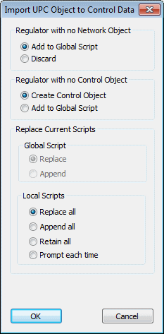

This dialog is used when importing a UPC
scenario into a control data object.
The UPC scenario controls are converted into UPC
script.
The dialog is displayed when a UPC
scenario is dragged from the Model
Group window or the
Explorer window to a network with associated
control.
Show image
| Option |
Description |
Regulator with no Network Object
Select an option for the action to be carried out if the UPC scenario
contains controls for an object that does not exist in the current network:
| Option |
Description |
Add to global script
Script is added to the Global UPC Script in the Global
UPC Script view .
Discard
The UPC scenario controls for the object are not imported.
Regulator with no Control Object
contains controls for a regulator that does not have Control Data in the
current control:
| Option |
Description |
Create control object
Control is added to the network object and the UPC scenario controls
are converted and imported into the local UPC script on the UPC
Script page
The UPC scenario controls are converted and added to the Global UPC
Script in the Global UPC Script view
Replace Current Scripts
Select an option to be used when importing scripts into control data
with existing UPC scripts.
Global Scripts
| Option |
Description |
Replace
Replace current scripts in Global
UPC Script view.
Append
Append scripts to current scripts in Global
UPC Script view.
Local Scripts
| Option |
Description |
Replace all
Replace any current local UPC scripts.
Append all
Always append scripts to current local UPC scripts.
Retain all
Do not make any changes to current local UPC scripts.
(Control data of objects that do not have a current local UPC script
will be updated with the imported script.)
Prompt each time
Displays the Import
UPC Object to Control Data dialog, allowing current and generated
scripts to be viewed before selecting whether to replace, append or retain
current scripts.
(A prompt will not be displayed for objects that do not have a current
local UPC script.)
