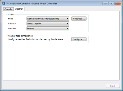

Weather Page
All fields on the weather page must be defined.
Show image
Weather Feed
List of weather feeds currently enabled for selection by the Weather Feed Configuration dialog.
Country
List of countries supported by the selected weather feed
Location
List of cities and other locations supported by the selected weather feed
Properties
Click the Properties button to set the connection properties of the currently selected weather feed.
The Weather Feed Properties dialog will be displayed.
Configure
Click the Configure button to select one or more weather feeds for use with the database. The Weather Feed Configuration dialog will be displayed.
