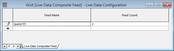

Live Data grid - Live Data Composite Feed view
This view allows live data feeds to be combined into composite feeds. A number of primary feeds are combined by addition and subtraction, by using a multiplier factor. Interpolation is used if time steps do not coincide.
The view is opened by double-clicking a live data configuration object in the Model Group window, then clicking the Live Data Composite Feed tab.
Note: Data in this view are used to generate Live Data Point ID, along with data from Live Data Feed and Live Data Point.
Item Description
Left-most column
If clicked, selects the whole row.
A forward triangle indicates the current row.
An asterisk indicates where a new object can be created by entering its details (in this case, by entering a feed name).
Fields
Feed Name
User name for the composite feed.
Feed Count
Read-only
Corresponds to the number of live data feeds used in the composite feed (feeds given a factor that is not 0).
Feeds Opens the Composite Feeds dialog, which is used to combine feeds into composite feeds. The dialog can also be used to test / check the results of the query.
