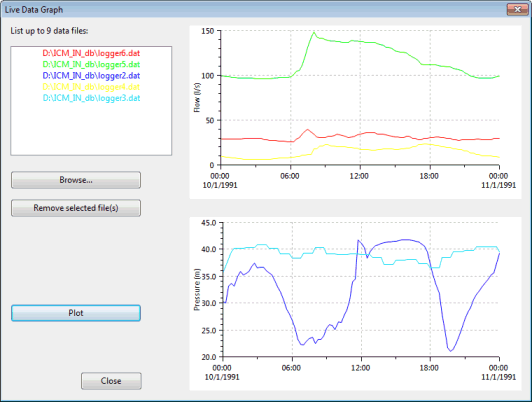

Graph live data directly from the files, without having to create a Live Data Point object in InfoWorks.
This dialog is displayed when you choose Live Data Graph from File from the Tools menu.
  • Use the Browse button to select logger files from your computer.
  • Use the Plot button to display graphs for the files in the list. Flow is displayed on the upper graph, pressure on the lower graph.
  • To remove files, click to select them and then click the Remove Selected Files button.
You can change the graph properties by right clicking the graph and choosing Properties . This will display the Graph Properties dialog.
