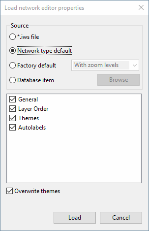

Load Network Editor Properties dialog
The Load Network Editor Properties dialog is used to load previously saved settings of properties associated with the network.
The dialog is displayed when the Load button is clicked on any tab or page of the GeoPlan Properties and Themes dialog.
Item
Description
Source
*.iws file
For loading an existing GeoPlan Properties file (.iws). Clicking the Browse button opens a standard Windows Open dialog, allowing you to browse for the iws file.
Network type default
For overwriting the current settings with the user default settings for the current network type.
Factory default
For overwriting the current settings with a choice of system settings.
With zoom levels A theme that changes which objects are displayed depending on the zoom level of the GeoPlan.
Base The classic theme.
Database item
For loading an existing Themes database item. Clicking the Browse button opens a dialog, allowing you to select the theme to be loaded.
(This option is disabled for Section properties and Grid layout properties.)
Browse Available for use with the *.iws file option and the Database item option.
Properties and themes box
Available when the Network type default option or Factory default option is selected.
Checked items will be loaded.
Overwrite themes
If checked, existing sub themes will be overwritten with new ones.
If unchecked, loading will not overwrite existing sub themes of the same name in the same layer.
