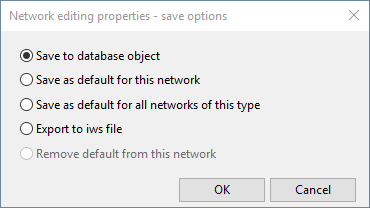

Network Editing Properties - Save Options dialog
This dialog is used to save the current settings of properties associated with the network.
The dialog is displayed when the Save button is clicked on any tab or page of the GeoPlan Properties and Themes dialog.
Saved properties can be loaded by clicking the Load button present on any tab or page of the GeoPlan Properties dialog.
Radio-button Description
Save to database object
Saves the current GeoPlan properties to an existing Theme Group. Clicking OK opens the Save Theme As dialog, allowing you to name and locate the theme, and then the Select Properties to Save dialog, allowing you to select which properties of the theme you want to save. The saved theme appears as a tree object in the Model Group.
Save as default for this network
Saves the current settings as defaults for this particular network. This applies to all users.
Note: Using this option results in the settings being saved as a network preference. In other words, this option will affect all users of that network once the network has been committed, and therefore it should be used with caution.
(The title bar of the GeoPlan Properties and Themes dialog indicates that theme and properties settings have been saved as network defaults).
Save as default for all networks of this type
Saves the current settings as default for all the networks of the same type. This applies to the current user only; that is, only the settings of the user who has selected this option will be affected.
No confirmation message is displayed.
Export to iws file
Exports the current settings to an XML format file (.iws).
This file can be reloaded at any time . See the Reloading saved themes section of the Managing Themes topic for more detailed information.
Remove default from this network
Enabled when settings have been saved as default for this particular network.
Removes the current settings from the network default.
