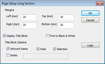

This dialog is used to set up the printing options for the Long Section window.
The dialog is displayed by selecting File
Page setup when the Long Section window is the current active window.
There is no print preview feature for the Long Section window.
| Item | Description |
| Margins | Enter values in millimetres for the left, right, top, and bottom margins of the printed page. |
| Display Title Block | Check to include a banner at the top of the printed page. You set the contents of the banner in the Title Block Options area, below. |
| Print in Black & White | Check to print the long section in black and white rather than colour. |
| Title Block Options |
Check an item to include it in the banner at the top of the printed page . To include your own notes, check the Notes box then enter text into the accompanying input box. |
| Logo button | Displays the Print Setup Logo dialog. This dialog allows inclusion of a user-defined title and logo, which will be printed at the bottom of the page. |
