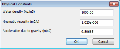

The Physical Constants dialog is used to set advanced run parameters: water density, kinematic viscosity and acceleration due to gravity.
When a new run is created, Physical Constants are set to the default values defined in the Run Defaults page of the Options dialog.
