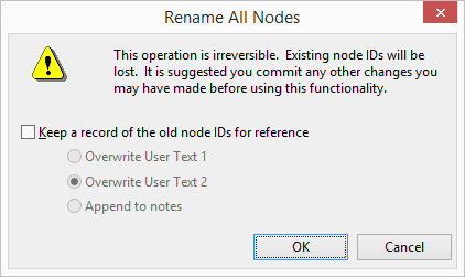

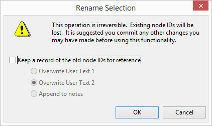

Rename All Nodes / Rename Selection dialog
This dialog is used when renaming nodes in the network as part of the automatic node name generation process.
The dialog is displayed when the Rename all nodes now button or the Rename selection now button is clicked on the Node Name Generation page of the Network Options dialog.
Rename All Nodes dialog Rename Selection dialog
Item Description
Keep a record of the old node IDs for reference Check this box to keep a record of the former node IDs in one of the locations selected below.
Overwrite User Text 1 If selected, the former node ID will be placed into the User Text 1 field, overwriting any data already in this field.
Overwrite User Text 2 If selected, the former node ID will be placed into the User Text 2 field, overwriting any data already in this field.
Append to notes If selected, the former node ID will be appended to the Notes field.
